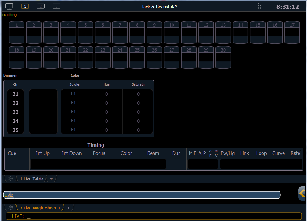

  • Hi Thomas,
    You could use a magic sheet to show the command line of any other user.
    Once you have put a command line of the magic sheet you just need to put the target as the user number.
    Then using the split screen to out it below a live screen so it can be seen. See below.
    Tom
  • You have an RVI for the designer? That thing is a client, so you don't need an extra dongle! And if you follow Tom's advice, you get the designer in his own partition with his own user number and still able to see the ion programmer's command line. Just start as Client instead of mirror mode
