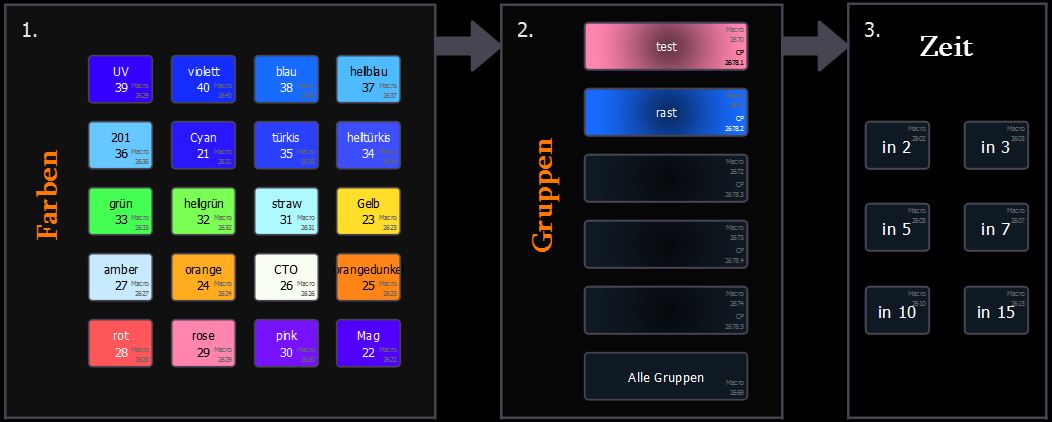

  • I think I once set up a system that does what you want. I never finished it though and never used it. I just wanted to see if it was possible.
    It looked something like this:
    What I did was set up some color palettes that were applicable to all my fixtures and also a number of groups (say Back/Sides/Backdrop/etc).
    I then set up the Magic Sheet you see above, where I would choose a color palette (1.) and the group I wanted to apply it to. (2.)
    The group buttons where actually macros that would copy the color palette I chose to a "placeholder" palette.
    Those placeholder palettes would then be applied to the groups in the specified sneak time (3.) all at once.
    So I would choose green for group 1 for example. The green palette would be copied to the placeholder for group 1 (say CP 101).
    Red for group 2. The red palette would be copied to the placeholder for group 2 (say CP102).
    And so on and so forth.
    When I pressed one of the Sneak macros, they would apply CP101 to Group 1 in the given time, CP102 to Group 2 in the given time, etc.
    I never got to expanding the system beyond color palettes, but it will be applicable to any other palette as well.
    This way you should be able to prepare a look with all the palette-types the board offers and then make it happen with the sneak macro.
    You might reach a point though, where applying all those palletes creates a noticable delay. Can't confirm that though, as I've never tried it. Just a thought.

  • I like this concept, it seems similar to Bartfly's method, with a nice interface. This seems like something that I could teach to younger students, assuming I make the macros as robust as possible. Thank you to you all for your responses, sorry for the late replies but you have all helped me out!
