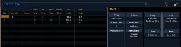

I have an ion xe
1)i want to have two lights start at 30%
2)then one of the lights go to 100%
3)then both off for a second
4)then both back to step 1
compleye noob
oh and I probably will need to be able to adjust the timing of how long the light fades up to 100% and how long they both stay off.

  • The step keeps running whilst the next step is running as well
    ie if first step is chan 1 in 1 dwell 1 deacy 1 step time 2  100% 0%
    and 2ndt step is chan 2 in 1 dwell 1 deacy 1 step time 2 100% 0%
    then chan 1 would fade to full over 1 second,  then wait for 1 second and then chan1 and chan2 would both change with 1 fading out and 2 fading in.  then wait for 1 second and 1 fades up and 2 down at the same time
    If the step time was longer than the component ie 4 with in, dwell,decay as 1 then its just going to wait 1 second before starting step 2
    You might also set the step time as zero on a steo if you wanted to change 2 things on the fixture at once.
    eg
    step 1  in 2 dwell 0 decay 0 step time 0  FP2 FP1
    step 2 in 2 dwell 0 decay 0 step time 2 100% 0%
    So the light moves to focus pallet 2 over 2 seconds, as well as fading up over the same 2 seconds and then goes out and moves back to FP1
