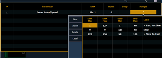

I have both the Apollo Smartmove DMX and the Roto Q in my rig and working with the built in profile. As both Rotators have their stop point at 0 rather than 50, (49/51 is extremely slow in either direction, 1/100 is extremely fast in either direction). I’m curious as to if it’s possible to create a custom profile where 0 is the midpoint and jumps to 51 or 49 as a plus or minus value to rotate either direction slowly? Looking at doing this rather than creating a cue to slow it down before sending it to 0 to stop it.
Hopefully that made sense,
