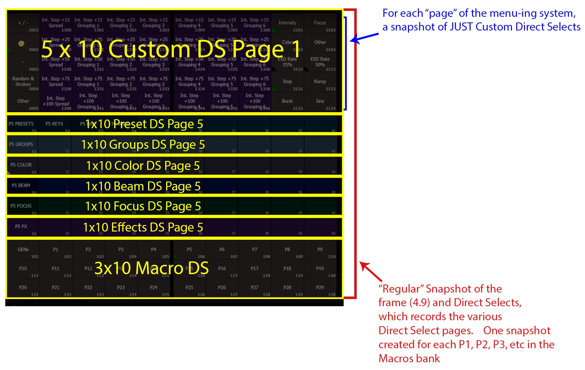

Snapshot of a single bank of Direct Selects

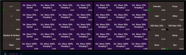

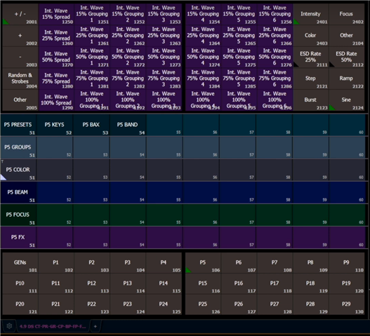

I cannot figure out how to make this happen.  When he shows the effects navigation on the right screen of the console, it takes up an entire tab frame.   I have figured out how to make that work.  However, he then reuses those Custom Direct Selects on the left console screen, it is 1 of 4 direct select banks.   The bottom 3 operate independently from the top one.
Unless he is making every permutation of screenshot between the bottom section and the top (29 options for the bottom x (at least) 36 options above = 1044 screenshots minimum), I can't figure it out.

    For the +/- option, there is Wave, Step, Burst and Ramp.   So that's 4 snapshots (which is essentially 4 pages of 5x10 Custom Direct Selects).
    For the next type of intensity effect ("+" option), there is Wave, Step, Burst, and Ramp.  4 more snapshots (4 more pages of 5x10 Custom Direct Selects).
    This continues thru "-", "Random/Strobes", and "Other".  So that's 16-20 snapshots (16-20 pages of Custom Direct Selects).   I am good with that and understand that.  When he has those on his right screen, they are in their own frame.  So I can, as you suggested Ueli, select just that frame, as well as "Direct Selects" and "Custom Direct Selects".    When I restore those snapshots, it will restore them into that frame (4.6 in David's example).   Good so far.
    When he goes over to his left screen, however, he shows the SAME Custom Direct Selects as were shown on the right screen.  The macro number for his "menu buttons" are the exact same.    However, this time they are in a new tab (4.9 on that screen) with 7 other Direct Select banks - Macros, Effects, Focus, Beam, Color, Groups, and Presets (from the bottom up).
    When clicking on the Macro Direct Selects, it "pages" through the Effects, Focus, Beam, Color, Groups and Presets for all 30 macros.  Those can easily be done with 30 snapshots.   HOWEVER, that FX Custom Direct Selects from the previous screen is also in that frame, meaning it would be included with that snapshot.

  • I believe I have figured out the answer.   For the top "menu" system, David is utilizing just a single "page" of Custom Direct Selects.   For every menu page, he re-populates the same 5x10 page of tiles.  Each time, takes a snapshot of ONLY the Custom Direct Selects - no visible workspaces, no frames.   When recalling those snapshots, he simply needs to have a Custom Direct Select 5x10 page on page 1 (or whatever), open someplace.   The snapshot will fill those tiles and nothing else.
    The rest of the frame is being handled with "regular" snapshots.   Clicking on P1, P2, P3, etc recalls a snapshot that has all the Direct Select banks set to a particular page.   However, the Custom Direct Select is always set on the same page, and so it doesn't change with each snapshot.
    I was able to replicate it on my own.  Clever guy, that David.
