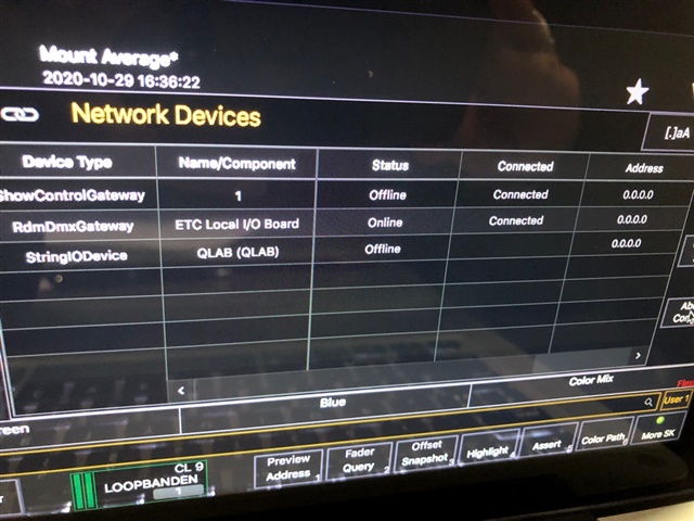

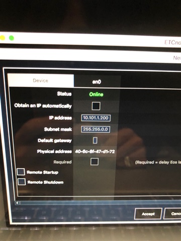

In the shell i am online but in the about window there is no network available?
Also no incoming osc commands..?
why could this be ? is it user related or something?

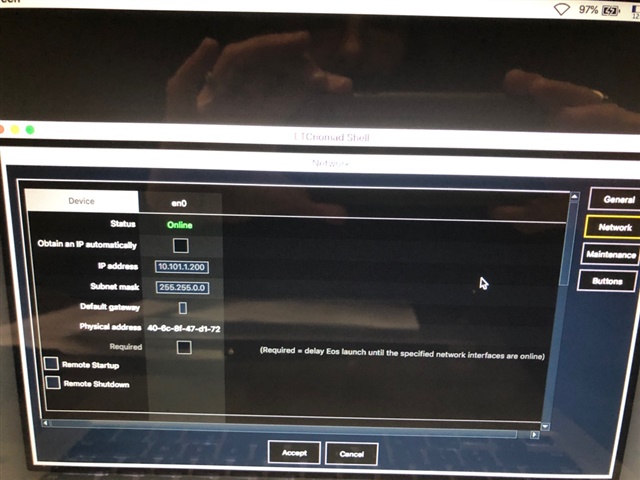

So in the shell

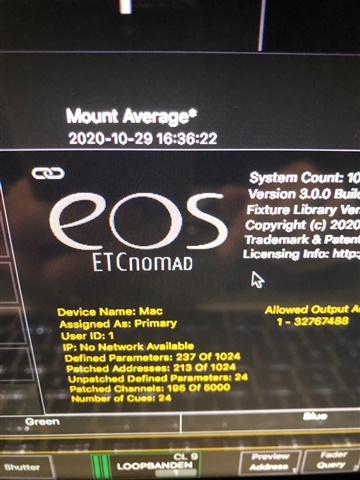

everything seems fine but when i go in ABOUT
there is no network
It's particularly on this macbook, what could it be?

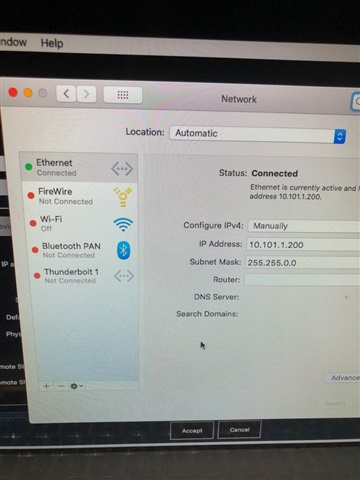

Try deactivating all other network cards. Nomad can only handle one, maybe there is confusion
I tried so many things already! including all the tips from tech support but it sounds mostly like this older post

I also double checked all my settings in the shell and all of the appropriate network settings were selected. It even displayed my network interface as being "online" which seemed like all was good.
However when I went into to "About" in the actual offline, it would display "No network Available" in the IP section.

I've checked all of my Mac's network settings many times, and my Firewall is completely disabled, so it doesn't seem like it could be that. I've tried re-installing the offline software as well and I still get the same results. I feel like there must be some random setting in a preference file or something that is preventing Eos offline from connecting with my interface...

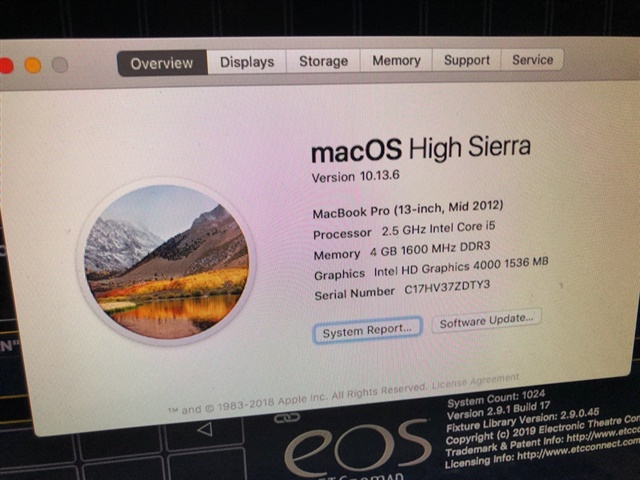

Specs: Macbook Pro 15" mid-2009, OS X 10.10.4, 8GB Ram, 256GB SSD hard drive, Eos Family version 2.3.1 (Also had similar issues with earlier versions 2.3 and 2.2)

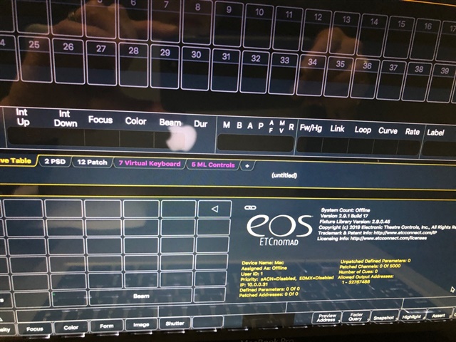

Can you please post a photo showing the entire about screen? Including version
