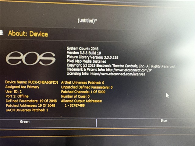

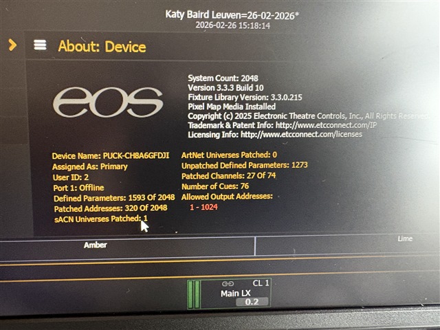

Hello an older model of puck is outputting only to conventional dimmers.
It refuses to control moving lights or LED lights.
The same showfile works immediately perfect running Nomad from a Macbook.
Any idea what could be the issue with the PUCK - is it a hardware problem ?
Same gadget from macbook, same simple dmx line, same showfile running nomad, everything works fine.
No reaction from LED or moving heads on Puck.
I can not see a different setting or where to look for the problem.
I attach the log file to this post, last show was 'Zero feet Away' perhaps you can see the problem?
On the puck
Eos 3.3.3.10
fixture library 3.3.0.215 october 2015
thanks! Anne ETC_Logs_Puck_Primary_20260204_142704.zip
