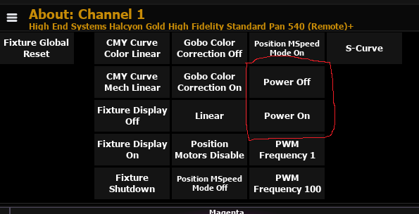

Above mockup from Remote Dimmer Fixture with a custom Fixture Power (Control channel Power - 0 is Power off Hold.  255 is Power On Hold
When you select Channel - it adds the Power off and on to its control channel
