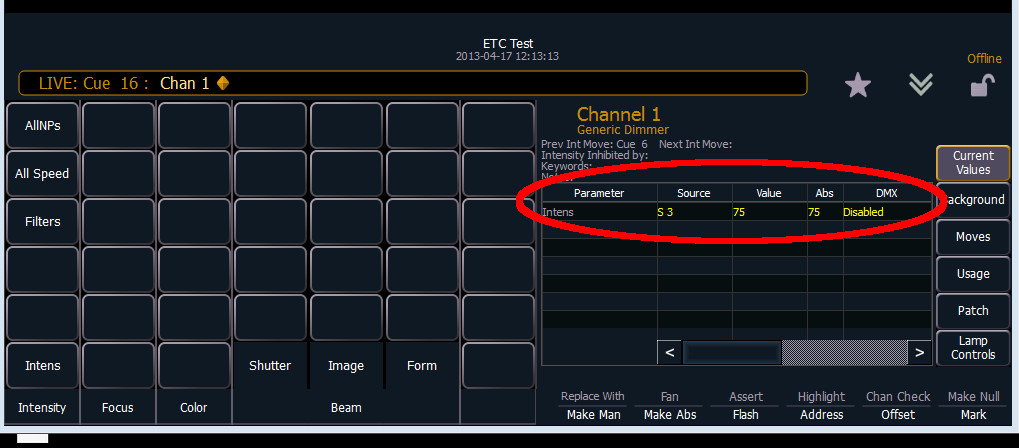

  • If you're ever uncertain of why a light has chosen to stay on, despite your best efforts, Channel [X] [Enter] [About]  is your best friend.  It will show you what the top value targeting your channel is.  In the example below, Channel 1 is held at a level of 75% by Submaster 3.
    Other examples of Source are Manual U:1 (you typed it in or brought up a channel fader) or Q 2 (It's recorded into a cue).
    "Background" shows you what other cues / lists / subs are targeting that channel at the same time.
