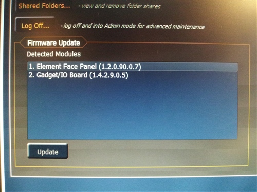

    so i looked in the Maintenance tab and got this screen:
    Firmware Update / Detected Modules:
    for both entry the update button is grayed out / not clickable.
    for the 'Gadget/IO Board' the Information to update it with the 'Upgrade I/O Firmware...' button is displayed.

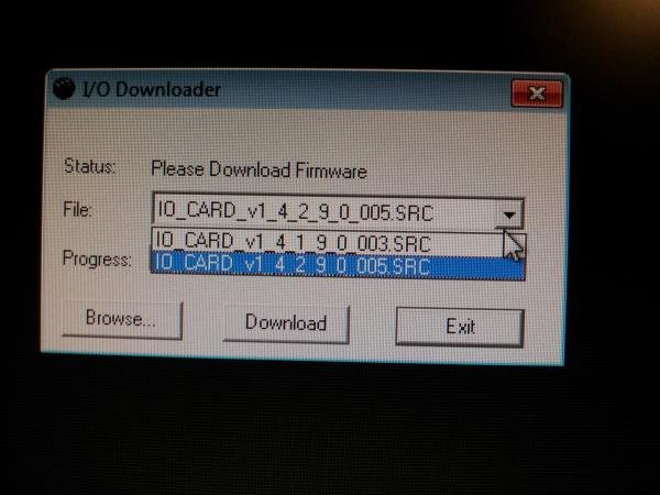

    If i try this i get a Dialog..
    after some waiting (it shows status information / starts connection...)
    i have a drop down with two entries:
    I/O Downloader
    i select the one with IO_CARD_v1_4_2_9_0_005.SRC
    and click 'Download'
    it  does something - the progress-bar fills up.
    eventually it finishes at one point it starts again with detecting.
    So i Exit. and Reboot - and back into the Maintenance Tab -
    but that seems to not satisfy the Firmware Update Manager.
    is there any other place to get a newer file from?
    and is the not updateable 'Element Face Panel' normal?
