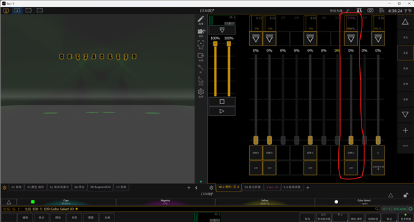

  • In Picture 1, these lamps are running an effect. I want to save the position material in this effect to the focus template. Because this design is very nice, I can do secondary programming.

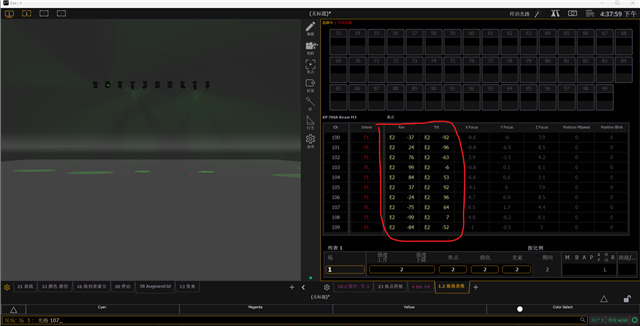

    It's not about recording the effect, but the position of a certain moment within the effect.
  • Ah, you're using the effect as a generator?
    In that case you'll have to use an effect with Stop&Hold function and stop the effect in the right moment. This will remove the effect, but leave its last values. These values are recordable.
  • After the effect stops, the lamp will return to its initial state and cannot remain in the position I want.

  • This way, the positions seen during the operation can be saved for later use.
  • Yes, I understand!
    The key is that the effect has an Exit behaviour of Stop&Hold.
  • NO,NO,NO
    I need to determine the exact position by adjusting the speed of the effect sub.
  • You can determine the exact position with your effect sub, but then you have to Stop the effect. If the effect is set to Stop&Hold the channels will stay in their position and you can record. Currently you can't record the resulting values if the effect is still active.
